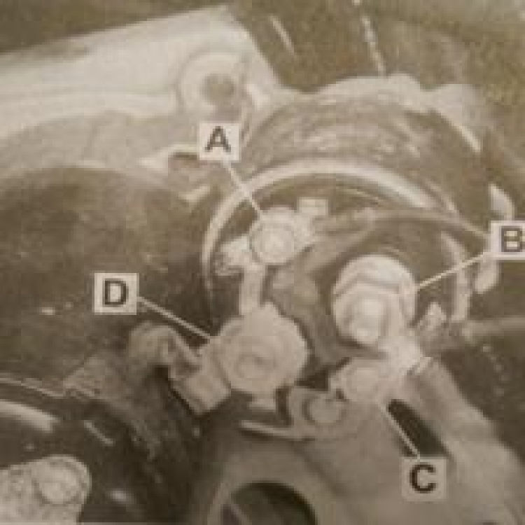

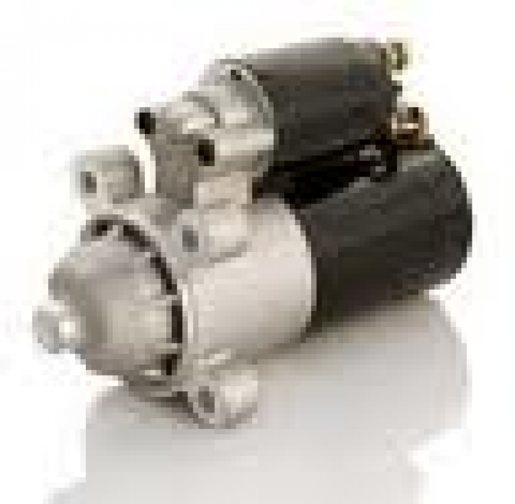

3. Starter
If battery voltage is sufficient at the starter's electrical connections and the starter is not cranking, it is most likely defective.
Replacing the starter isn't easy, so make sure the diagnosis is correct before you undertake this task.
Suggestions for troubleshooting:
Remove the airbox and the intake boots to gain access to the starter.
Measure voltage on two of the terminals on the starter solenoid.
Terminal "B" should have constant battery voltage.
Terminal "C" is energized by the ignition switch via EWS module when starting the engine.
Remove the wire from this terminal, measure voltage on the wire with the key in start position.
If sufficient battery voltage is present at both terminals and the starter isn't cranking, it is defective.
You can also test the starter by jumpering, or "hot wiring" it.
This is done by applying direct voltage to some of the terminals.
When voltage is applied to terminal "D", the starter motor should spin without cranking the engine.
When voltage is applied to terminal "C", the starter should crank the engine.
Make sure you have good engine to chassis ground.
Sometimes there is a bad connection at the ground strap that is under the engine on the passenger side.
The starter can also get stuck. If voltage is sufficient, but the starter only clicks, this may be the case.
Tap the starter while a helper attempts to crank the engine. If it is stuck, this may get it going.

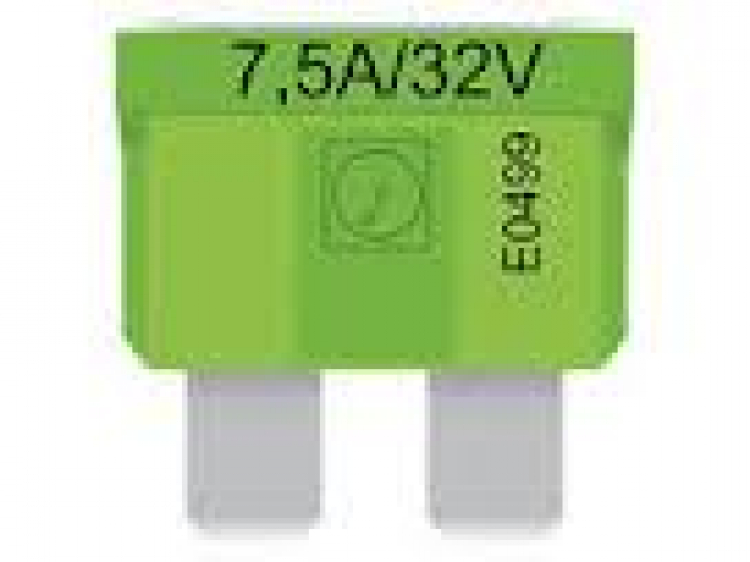

b, Fuses
- E-box fuse pack: under the hood on the driver's side where the DME and other electronic components are located,
there is a fuse pack, containing 5 fuses. These are related to engine management.
Fuse #3 sends power to both fuel pump relay and the crank sensor. (see photo in post 142)
- main fuse panel: check fuses 9, 22, 27, 29, 30 (ignition switch), 54 (fuel pump), and 14, 49, 67 (EWS).
Inspect all fuses in the glove compartment if you're dealing with a hard to diagnose no start problem.
- high amp fuses above main fuse panel (fuseable links).
There is an 80 amp for the DME and DME main relay, and a 50 amp fuse for the ignition switch.
- main harness fuse: behind the carpeting on the passenger side shock tower there is a large fuse.
The cable here supplies the relay panel, so if this fuse is blown, almost everything will be out.

3. Starter

b, Fuses
