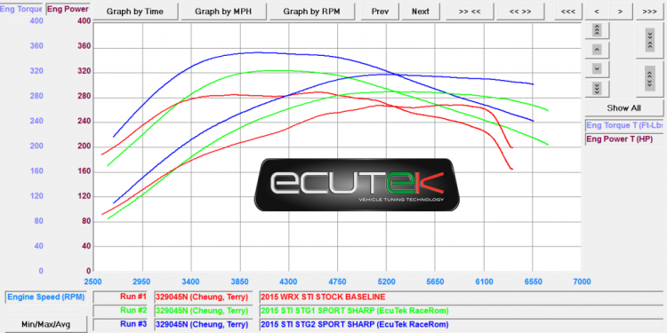

2015 STi tuning với EcuTek, em thấy trên nasioc...
Car: 2015 STi
Tuner: Visconti
Dyno Info: Mustang AWD-150
Peak HP at RPM: 319WHP @ 5400
Peak Torque at RPM: 355WTQ @ 4200
Baseline hp/tq for a stock on same dyno: 268WHP / 280TRQ (Peak)
Target Boost: Intelligent - Wastegate / Sport 17PSI / Sport Sharp 20PSI
Target AFR: 11.0
Fuel: 93 unleaded
Engine/Power Modifications: Visconti STG1 EcuTek Tune
STG1: Visconti STG1 Flash Only (EcuTek)
STG2: Visconti STG2 Flash - Downpipe, Q300, AEM Intake (EcuTek)
